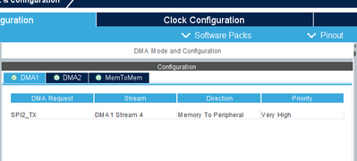

Thanks for your help.
See Pic.
When you say set the interrupt priorities of DMA higher than the EXTI do you mean as defined in the picture above?
I have changed the value in the priority field from low to very high. This has not resolved the issue.
