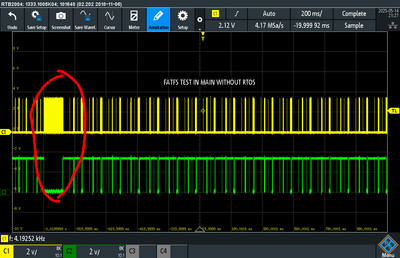

I'm trying to implement a sd card interface for the STM32U5 series using SDMMC1 interface. Since there is no native FATFS support over CubeMX, I guess, I started to use the generic fat file module from elm-chan.
Basic configuration:
1. SDMMC1 in SD 4 bits wide bus mode, clock divider 4, power safe for clock enabled, no hardware control, no external transceiver, SDMMC1 global interrupt enabled, gpios pullup all enabled despite of clk
2. Modified diskio.c see code example
The interface works and I can also kind of work with fatFS, f_mount, f_open works basiclly, but sometimes I got a FR_DISK_ERR. On my scope I can see that the SD clock is always on when the error occures. So I think there is an issue with the low level driver level or better say somethimg is going on with the diskio layer. Please see the attached pictures of working f_mount and f_open and the f_open where the clock doesn't stop.

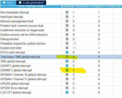

Hello @Julian_
You did check with priorities of Timer (Timer used as time base) interrupts higher (Lower numerically) than SDMMC.
Saket_Om

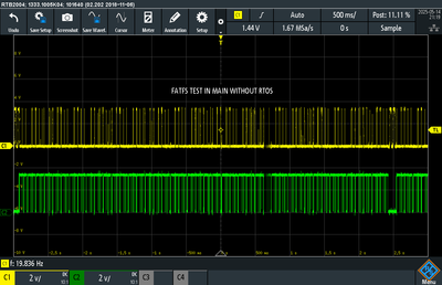

@Saket_Omwhen Time base: TIM2 global interurrupt priority is set to 4 and SDMMC1 global interrupt to 5 the test code finally works:
Runs in a while true loop and I checked the scope, seems to work:
maybe this sequence is a little bit suspicious, but all in all there is not the "never-ending-clock-issue":

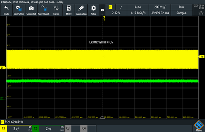

When running or accesing the sd card over fatfs in a rtos task the issue still appears:
So I guess we can say that HAL Layer works, fatfs layer works but with the rtos it doesn't work. Please note that you can read files over fatfs in rtos to but sometimes there is that issue - seems like that maybe the hal driver for sdmmc is interrupted by the rtos sheduler or similar...

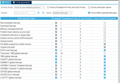

Hello @Julian_
When using FreeRTOS, ensure that interrupt priorities are not set higher (i.e., lower numerical values) than the default priority level of FreeRTOS, which is 5.
/* The highest interrupt priority that can be used by any interrupt service
routine that makes calls to interrupt safe FreeRTOS API functions.  DO NOT CALL
INTERRUPT SAFE FREERTOS API FUNCTIONS FROM ANY INTERRUPT THAT HAS A HIGHER
PRIORITY THAN THIS! (higher priorities are lower numeric values. */
#define configLIBRARY_MAX_SYSCALL_INTERRUPT_PRIORITY  5
Saket_Om

@Saket_Omunfortunally no. I tried to change the interrupt priorities according to the
but this doesn't work well. In addition to this I also disabled the SDMMC1 interface interrupt, because we're using the interface in pulling mode, see fatfs diskio.c I already shared in this thread.
