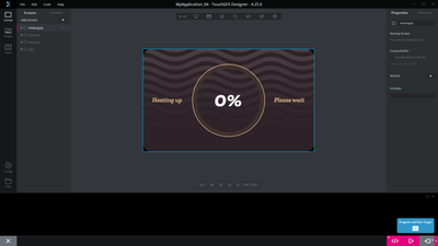

Also, the examples in STM32CubeIDE don’t seem to have a proper TouchGFX integration for this board and the TouchGFX Designer demos I tried show corrupted graphics on the screen.

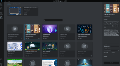

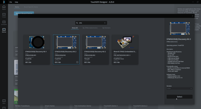

You should be able to create a project on the TouchGFX Designer for your STM32U5G9K-DK2 without issue.
Here are the steps:
  1. Open TouchGFX Designer, click on "Demos" then "Select Board Setup", type "U5G9" and select your board (there is a FreeRTOS and a ThreadX version)
  2. Select a demo and click on "Create"
  3. Connect your board and click on "Program and Run Target"
By following this steps you should have a working demo on your STM32U5G9J-DK2.

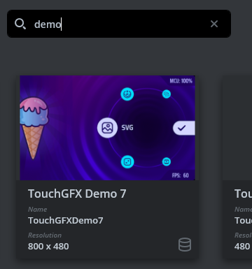

@ArunJohn
"the TouchGFX Designer demos I tried show corrupted graphics on the screen."
I tried to run Demo 7 from GfxDesigner and it works Okay on my board. Which demos are corrupted on your board ? I'll try those.

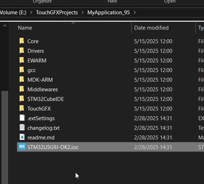

One more thing - would it be possible to also share the a sample .ioc file used for this demo project (or any similar project for this board)? I’m mainly trying to understand how the LTDC and TouchGFX middleware are configured, and having the .ioc  as a reference would make things a lot easier to replicate.
Appreciate the support!
Hello @ArunJohn ,
You can just create a project using the STM32U5G9J-DK2, it uses LTDC:
Then click on the folder icon to open the file location:
And then you can navigate you level back to find the ioc file:
