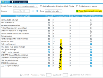

Could you share your interrupts priorities setting please?
Saket_Om
@Saket_Omof course, please note that I disabled SDMMC1 global interrupt because we are using polling (HAL_SD_WriteBlocks, HAL_SD_ReadBlocks, HAL_GetCardState as shown in the diskio.c already shared) therefore no need for enabling the sdmmc1 gloabl interrupt- in my opinion.
I also testet the behaviour with interrupt settings marked in yellow.
There is also a Communication Task running in parallel in RTOS which uses UART in DMA mode - so maybe the yellow marked tick (force DMA channel interrupt marked) should be disabled??
