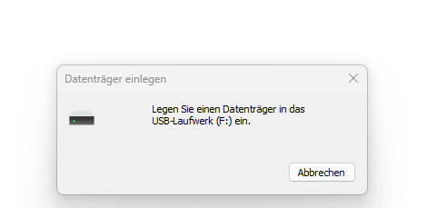

The only thing being different is at "STORAGE_GetCapacity_FS", where I tried to get the data immediately from the SD-Card. I've tried both versions, but it didn't change anything.
At the end, after starting the program, the pc will open up the explorer automatically just to inform me, that there is no disc in (F:): 0693W00000WKFLCQA5.png
I'm thankful for each advice, what else I could try out.

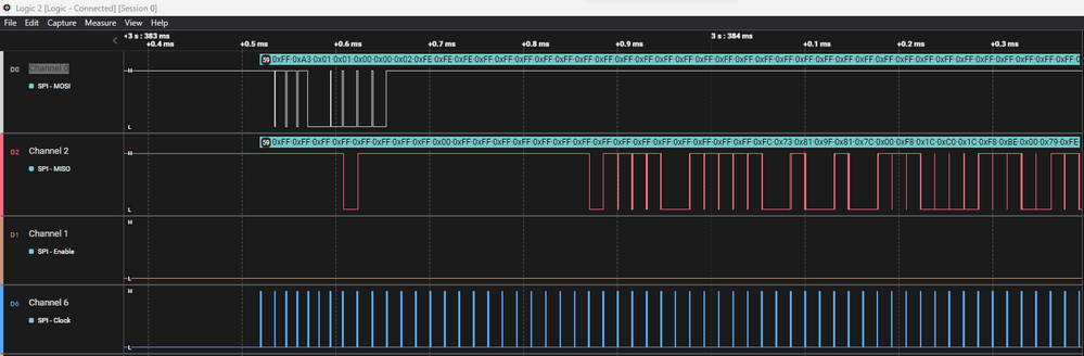

Instrument the code so you can see via a serial port, real-time, what interactions are occurring.
The media will start unformatted. Sorry can't translate bitmaps.
If it complains about no-media, start by looking at that test first.
NW.2
Hello Tesla DeLorean and thank you for your reply.
I don't quite understand what you mean by displaying the interactions I'm receiving via a serial port. I'm not quite sure if I can use the serial port and the mass-storage device at the same time. One thing I tried out was connecting the four functions used in the usbd_storage_if.c file with LEDs and see, if they receive a valid return from the FAT FS Functions.
I could see that SD_disk_read worked and returned a 0 (USBD_OK). Removing the sd card while the program was running made the LED stop blinking (therefore returning a USBD_FAIL or something similair). Meanwhile, SD_disk_write is never used, aswell as the function STORAGE_Write_FS in usbd_storage_if.c.
I've tried to display the SD-Card SPI via a logic analyzer, but I'm not quite sure what I've to expect:
Kind regards
