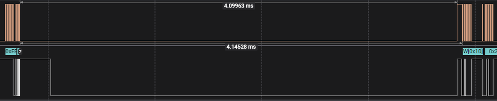

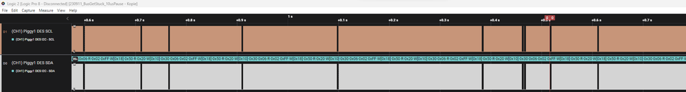

Hello @Issamos ,
I have used a logic anaylzer to record several measurements. Please note that for this measurement I changed the timeout value to 4 ms.
This images shows a lot of visible situations where we had an timeout occuring.
Here, the bus got stuck during reading from an address. (First images shows the timeout -> SCL was kept low. Second images shows the zoom at the start)

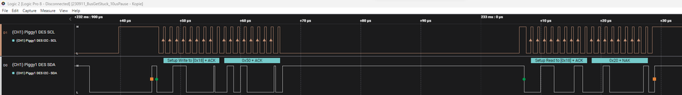

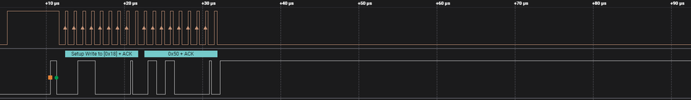

In this image you see the same transmission than above, without an timeout:

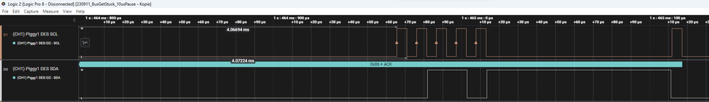

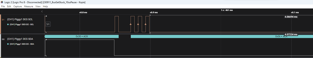

In some situations an already active Bus (accessed by the external I2C Master that runs in normal mode) got blocked by the STM32L4 for 4ms during an active transmission (First image shows start of transmission. Second image shows end of transmission):
