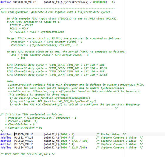

I use the PWM output example code of STM32CubeIDE,
how do I modify the duty cycle of the PWM, I can't find a way to modify it

Hello Jason,
You can simply change the PULSE_VALUE in the main.h
Regards,
Stassen

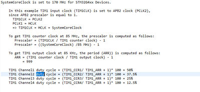

Hello @Jason_fx
TIMx channels duty cycle = (TIMx_CCR1/ (TIMx_ARR + 1))*100.
You can change the values off TIMx_CCR1 and TIMx_ARR to modify the duty cycle value.
Best regards.

Hi Stassen,
Thanks for your reply.
But I have a question,
I find this code but I can't understand how to change the PULSE_VALUE,
example code is output PWM has a 90% duty cycle, if change 50% duty cycle how to set the PULSE_VALUE?

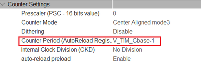

hello @Jason_fx
you can simply set "duty * counter-base-period" to "Compare Register" just like followings..
 where V_TIM_Cbase is defined in configration as below.
hope this could help
regards

hello, @Jason_fx
off course join the codes into your main() or some applicable place by yourself.
and, if the Counter Period in your project is for example "999" (=1000-1), I mean V_TIM_Cbase = 1000,
then it should be refered in the code which I show you.
if your sample code is as below,

Hi @mxo
I can't find the ___HAL_TIM_SET_COMPARE function on the PWMOutput sample code
I tried changing #define PULSE1_VALUE (uint32_t)(1000 / 2) to #define PULSE1_VALUE (uint32_t)(50000 / 1) and it outputs 76% but I don't understand code work logic.
hello @Jason_fx
you can find in stm32??xx_hal_tim.h. (?? = depends on your project, I guess)
One important thing that duty must be 0 ~ 1 (or can say 0 ~ 100%).
is your sample project 'TIM_PWMOutput', right?
#define PULSE1_VALUE (uint32_t)(50000 / 1)  .. means over 100% duty.
since the base period is 1000 in that sample project, pulse value should be 0 ~ 1000, or result is unexpected.
TIM_PWMOutput project only shows set duty (=pulse value) at configuration time.
better to find some other samples to understand function, then this can be enough to talk, I think.
regards.
