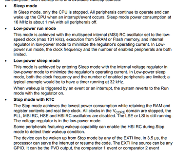

Additionally, I was thinking that instead of running the CPU in normal mode during the awake time, perhaps I can run it in some other mode?
Can I use Sleep mode (not standby) or low-power run mode and still use SPI/I2C interfaces?
I am happy with the standby current consumption but I would like to reduce the awake current consumption (5mA)
‎2023-09-15 7:49 AM
Even if that's possible (I don't know), it's a trade between "some-slow-mode-that-takes-longer" vs. a short regular CPU use.
So just try...

‎2023-09-22 5:57 PM
How often are you planning to wake up and send a LoRa packet?
2uA in STOP2 is about right as is 5mA in run mode. Your dominant power user will be the radio Tx, so on-air time and Tx power will drive your battery life.
For example, sending a packet every 5 minutes, if your Tx current is 100mA with a duration of 42ms, and you have two receive windows (for LoRaWAN - ignore otherwise) that use 5mA for 140ms combined, and an idle current of 2uA, you are looking at near 10 years battery life from a CR123A cell.
With LoRa, you can drop the Rx frames and if you also drop the Tx power to 50mA, the battery life is something around 19 years.
Build yourself a bit of a spreadsheet and play with the numbers - there may be better power optimisation opportunities to chase.
