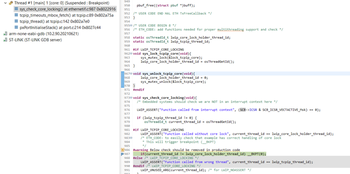

trying to get a setup with stm32h753 running FreeRTOS and LwIP. One attempt in this journey was to take the example: How to create project for STM32H7 with Ethernet an... - STMicroelectronics Community
Using the example code, I see one issue with the core lock - if the breakpoint in ethernetif.c line 987 is enabled I see the code suspends in places one would not expect it to suspend such as:
If I disable the breakpoint, ping works ok.

Pavel A.
When the BKPT hits, what is the thread id?
Suspecting it is a DMA issue
Is DCACHE enabled? Are you using a concrete example project from the CubeH7 package or the "hotspot" repo, or rolling your own by following the how-to article?

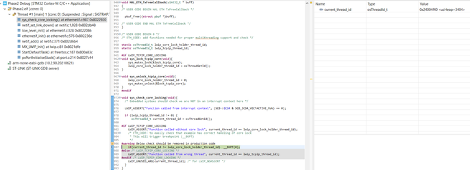

Greetings,
for the thread ID, see below.
The code is based on a copy from the "hotspot" repo(version 1.2). But on top of that is the httpd server from CubeMX amongst others.
DCACHE is enabled.
Pavel A.
Hmm, the call stack shows that netif_set_link_down()  expects to be called under the LwIP "core lock". ... I'm not sure whether this function actually requires the lock, but lets assume it does. So acquire the lock in your low_level_init() and other places around calls to netif_set_link_down, netif_set_link_up.
>DCACHE is enabled.
Don't enable DCACHE for debugging. This won't completely remove the cache related issues but should make debugging easier on bring-up stage.

Piranha
Chief II
The core lock test fails because some code does not respect the lwIP multi-threading requirements. The "Hello UDP" example form the "hotspot" even demonstrates how to write a broken code. And the lwIP driver has a deadlock in Tx code. All of it is reported in the link I gave previously. There is no point in poking random features and doing other voodoo magic before the lower layers of code are fixed.
