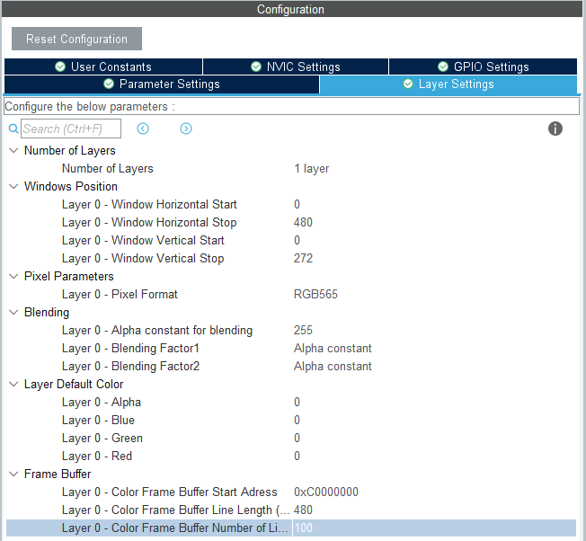

I then continued to this guide (https://support.touchgfx.com/docs/development/board-bring-up/how-to/03-display-internal). I was able to see the LTDC interrupt working by utilizing break points in the debugger. I started with a partial framebuffer of 480x100. This way I am sure that it fits in the internal RAM.
However, I was not able to get a red screen, as I would expect following the tutorial. My screen stays black. I am unsure what I am doing wrong. I am also unsure what I should put in the 'Color Frame Buffer Start Address', since it seems I should declare the framebuffer myself? I feel like I am missing something, but I don't know what or where to look.

The issue here is the ram that is, by default set in DTCM zone which cannot be read by the LTDC. More information here Solved: Unable to get LTDC to output contents of Frame Buf... - STMicroelectronics Community. In general, please avoid answering to an old thread and open a new one instead.

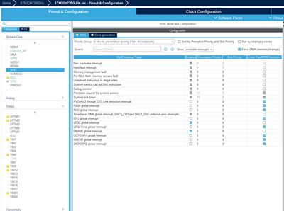

I briefly looked at your project and from the symptom you mentioned, I guess it could be due to some of the priority in here :
The lower the number of the "Preemption priority" is, the higher is the priority.
