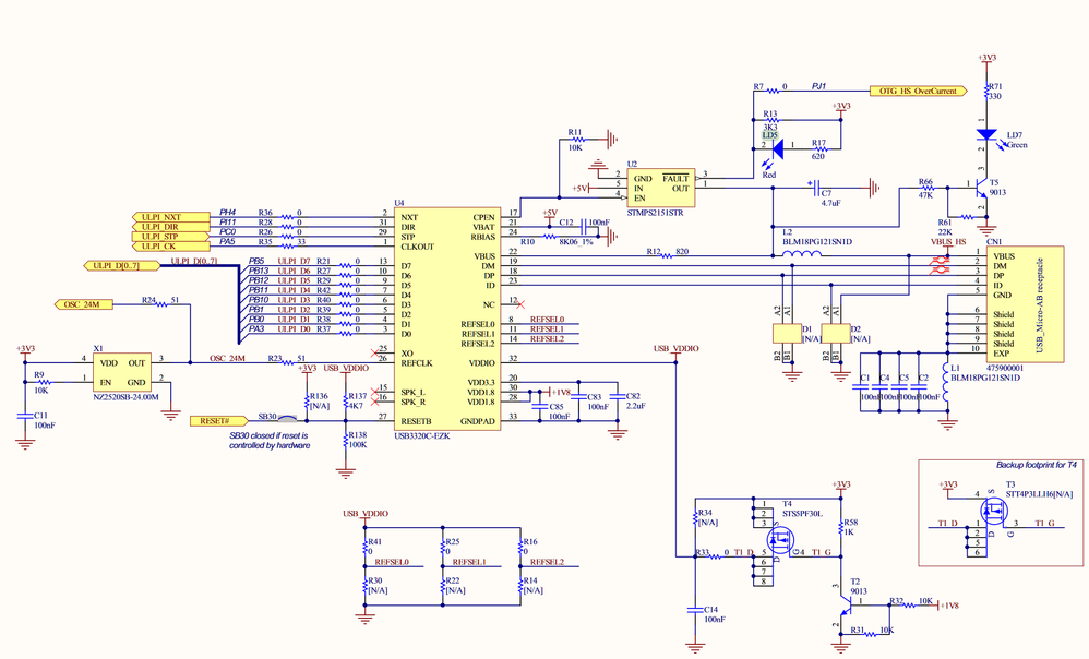

Here: USB3320 - it's installed on board. Pasted from the documentation.
The question is - WHY IS LD5 on? It is on even it's nothing connected to the P1 port. When I was doing previous tests it was off, now it's on all the time, have I somehow fried my board? I rather don't think so. BTW, when the board is reset, the LD5 goes off. During programming it goes off. It goes on shortly before LD7 indicating the VBUS.
‎2022-08-17 11:05 AM
Read the DS of the switch which lights it up (unless PJ1 is turned to output and low, which is probably not the intended operation and which you check by looking at content of GPIOJ registers). Find out what are the conditions of given output to go active etc.etc.

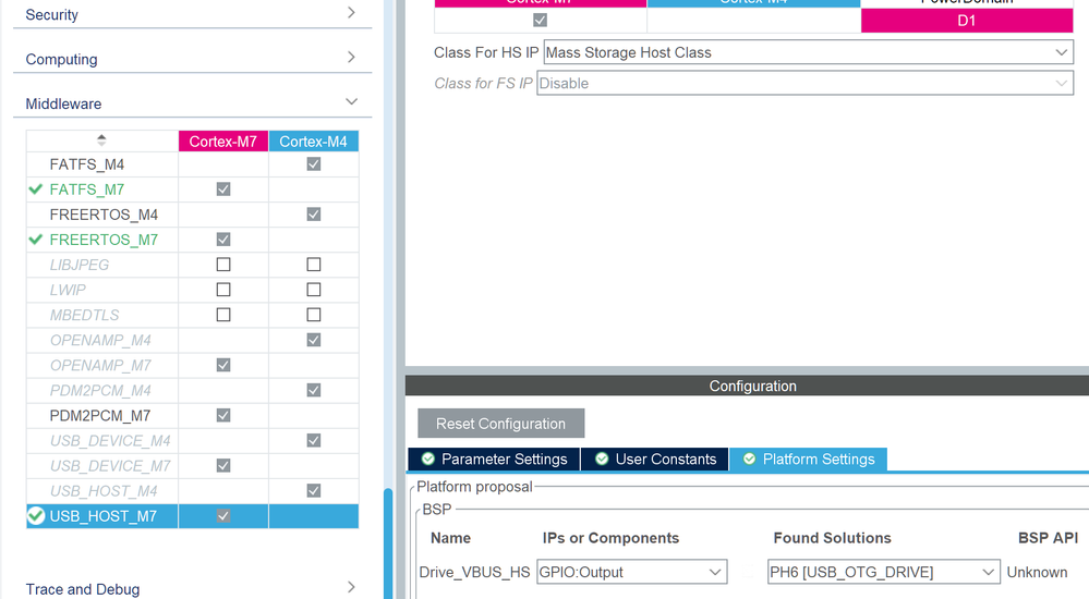

You were right about PJ1 - I chose the RANDOM pin for Drive_VBUS_HS option. It was PJ1. I changed it to another free RANDOM pin:
Now - LD5 is off, LD7 is on, so... I guess the power is OK.
Now about copying and pasting. I do not do it. However, I use code generator from STM32CubeIDE. People often rant on HAL drivers, but it's all a matter of time - I don't have time to write my low level drivers. I made a quite big project from scratch, learned the STM32H747 from zero. I used a lot of features, configured a lot of custom options, it's such a hog that I'm almost out of free pins on the board. Everything except the USB OTG works. That's the last single thing that doesn't work.
Of course I use a debugger to debug both my code and the drivers. But here... Excuse me, but the problem is a little beyond my experience and knowledge. That's why I ask.
BTW, I found a lot of bugs in STM32CubeIDE code generator and HAL drivers. I fixed most of them. I fixed broken I2C driver (at least to a point where it's kind of usable, it still depends on spin wait on some features that is terribly wrong), I fixed GPIO mayhem generated when USB_OTG_HS External HS is used. I fixed the default memory caching setting that causes HAL DMA code to break. I fixed broken animations in TouchGFX. I don't use automatic clock settings solver - it doesn't work properly, I configured the clocks manually. So - let's say I at least try to do my homework.
Now about the hardware - it's Discovery Kit. Nothing else. Well - a USB pendrive, tested with my phone, it works. The STM32H747I-DISCO was probably tested, they wouldn't release it if something didn't work in it. I'm still convinced that the OTG should work as expected, however, there's something I'm missing here. Now I have VBUS power, no conflicts on pins, proper clock provided (48MHz), everything initialized - it still doesn't work.
Maybe I shouldn't specify just a random GPIO for the Drive_VBUS_HS feature? But what pin should it be? I can't find it in any documentation. There is a similar feature to SD Card. The pin is specified in the manual. It's SD Detect pin. It's both on the schematics and in the description. But for Drive_VBUS_HS - even Google finds nothing.

According to the answer - any GPIO pin. So power's OK, clock's OK.
