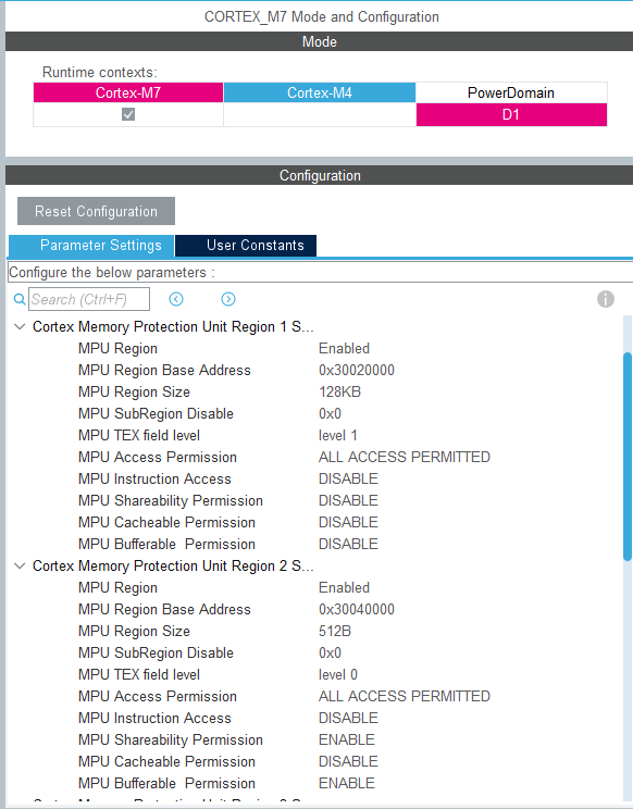

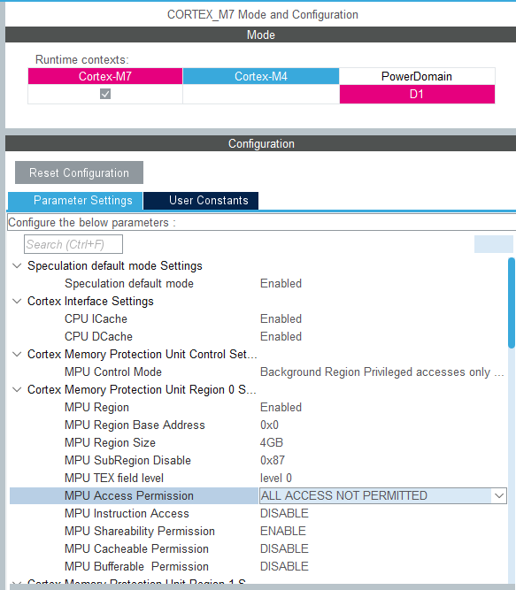

I am developing a TCP server application using STM32H745ZITx microcontroller. Both CM7 and CM4 cores are active in the system and FreeRTOS is running. Ethernet operations are done in the CM7 kernel. However, after the accept() function is called, the related task does not run again; there is a task crash in the system. I cannot find the source of this problem.
1. MPU settings
2. LWIP Heap Settings
Problem Summary:
       - socket(), bind(), listen() functions work fine.
       - When accept() is called, the task does not run again.
       - The prvCheckTasksWaitingTermination() function of FreeRTOS is called and the task is deleted.
       - Linker, MPU and LWIP configurations are according to STM's examples.
       - No compilation error or overflow warning is received.
At this point, what could be the cause of the task crash after accept()? I think it could be caused by MPU, LWIP stack, or FreeRTOS configuration, but I could not pinpoint it.

KemalUzgoren
The problem was caused by using the Socket API (socket(), accept()) in an RTOS environment. STM32 examples (like STM32H745_NUCLEO_M7_ETH) use Raw TCP API (tcp_new(), tcp_accept()) instead.
After switching to the Raw TCP API, the accept callback started working correctly.
Hope this helps!
