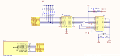

Please find the Image of the connections for your reference.
Kindly provide the valuable suggestion to clear out the issue to move the product in production.

Meanwhile I want to know that I am able to measure the clock(24MHz), cmd, data and cd on CRO. We can see that the cd pin goes low when sd card was inserted and default is high.
As we have two board, out of them, in one board sd card is working and other board sd card is not working, Here the hardware and software are same in both the boards.
Can you please confirm that the issue is whether hardware side OR software side?
so we can focus on that part as the schematic is attached in this post previously.
Regards,
Alpesh
if same software, there is a hardware problem in the not working board.
Both the boards have same hardware and same software.
Regards,
Alpesh
Right, i seen.
But the not working board has a hardware problem...maybe bad solder /contact ...you have to find.

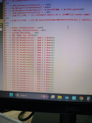

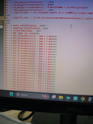

I have checked the Hardware connections and make rework.
After rework, the SD card communication is started but after few minutes, it was showing the error. Again, start the board and the same situation observe like after few minutes, it shows the error.
Also attached the log images for your reference.
Regards,
Alpesh

> I will try with the mentioned solutions
-- Did you ??
How should i know, what the ...read 1 3 0x4  is meaning ?
