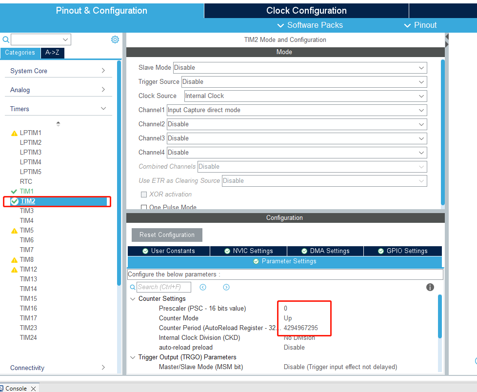

Currently using NUCLEO-STM32H723ZG board.
I'm setting TIMER1 as a PWM output, TIMER2 set as Input Capture direct mode
try to measrue the frequency output from TIMER1.
Clock Configuration : APB1/ APB2 Timer Clocks 100 (MHZ)

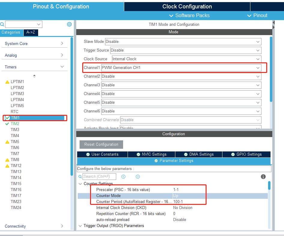

Timer 1 :
  • Prescaler : 1-1
  • Counter Period : 100-1
  • PWM output
Timer 2 :
  • Input Capture direct mode
  • Prescaler : 0
  • Counter Period: 4294967295
_legacyfs_online_stmicro_images_0693W00000bjeLdQAI.pngWhenever I modify the TIMER1 output PWM over 200KHZ, I can't get the stable value or even zero from the ​HAL_TIM_ReadCapturedValue.

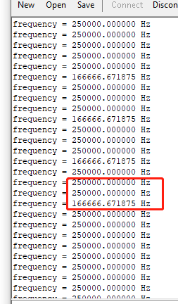

But I got read back like this.
Idealy TIMER2 run under 100MHZ( APB/PSC) should be able to capture up to 10MHZ signal.
eventually I need to measure a signal up to 100MHZ, If i set the APB bus to Max frequency (137MHZ) will this method works? or is there any other way to measure it?
Hardly so. With Cube/HAL, and optimizations switched off, hundreds of cycles per interrupt are the norm.
Even using DMA it would be a challenge to measure 1/10 of timer clock reliably by using captures.
Try timing a number of input clocks using external clock mode and a second timer as a time base.

TIM1 : Internal Clock, PWM Generation CH1, PSC 275-1, Counter Period 100-1. ( Which will generate 10KHZ PWM output)

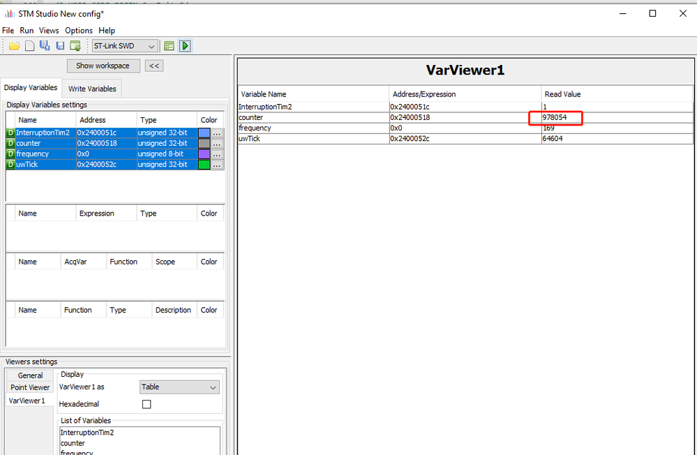

However, every time I add the interrupt function for TIM5, it causes an error in my output. The value of __HAL_TIM_GET_COUNTER(&htim2) should always be less than 65535, as I have set it, but it always exceeds this limit. As you can see from the counter value below, it is over 65535.
I am not sure which part of my settings is incorrect.
