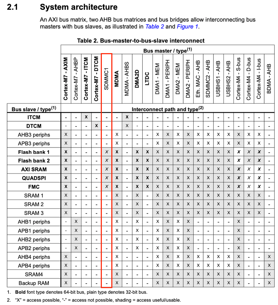

Did you try to set a breakpoint in HAL_SD_ErrorCallback to see if you have an error in hsd->ErrorCode ?
MA4
Senior
Is your buffer in an accessible memory ?
rtonet
Dear MA4,
My buffers are in RAM_D1. It seems that the problem is related to threads. When only the SD card thread is active, the system operates correctly, even when writing 4096 bytes every 2 milliseconds. I already tried setting the SDMMC interrupt priority higher than all the others, but it still does not solve the issue. By setting the SD card thread with the highest priority, I avoid errors. However, the rest of the system eventually fails.
I need to better understand the impacts of the other threads on the SD card operation and vice versa.
