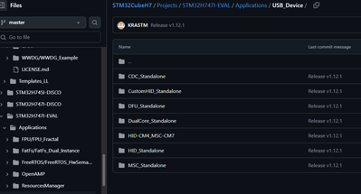

skson
Dear,
I'm appreciate your fast response.
1. Just following your advice, I enabled CRS SYNC with USB HS instance but there is no changes...
2. additional code : HAL_Delay(10); If it does not added, the code is stopped while running MX_USB_DEVICE_Init(). While debugging, it is result of trials, to avoid the runtime error.
I don't know why, but added this delay, it passed well.
3. I understand your wording as : there is an example of H7 USB Device - USB OTG HS Audio class.
If you share it correctly, it might help.
But I cannot find "Audio_Standalone" example in ./Projects/STM32H747I-EVAL/Applications/USB_Device/ folder.
To me, it seems like under :
Best regards,
From Son.
FBL
Hi again @skson
Some middleware libraries along with the projects are not available on Github. You can find them directly when downloading from STM32CubeH7.
Best regards,
FBL
