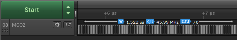

According to the STM32H745xI/G datasheet, the 64MHz HSI is accurate to +/- 0.3 MHz around room temperature, so +/- 0.5%.
During testing, I noticed about 10-20% of my UART characters were getting dropped. I then looked at the signal on a scope and noticed the frequency is off.
After redirecting the system clock to MCO2 (PC9) and measuring on a scope, I discovered the problem:
The HSI RC (64 MHz) on the STM32H745 chip is off by 4%!! So much for the "factory calibration".
Am I missing something here?

HAL_RCC_MCOConfig(RCC_MCO2, RCC_MCO2SOURCE_SYSCLK, RCC_MCODIV_10);
Measured frequency is 45.99 MHz, which is -4.2% off from what it should be: 48 MHz.
If I change to 400MHz, the result is the same. -4.2% from what it should be.
Solved! Go to Solution.

Yep, that's the problem. CubeMX sets HSICAL to 0x20, which is different from its reset value of 0x40. After changing it to 0x40, the clock is now at 48.25MHz, which is an error of +0.5%.
Yet another instances of the hardware being fine but CubeMX producing a bug. I had thought at least the power initialization in CubeMX would be robust.
My chip revision is V (REV_ID = 0x2003).
