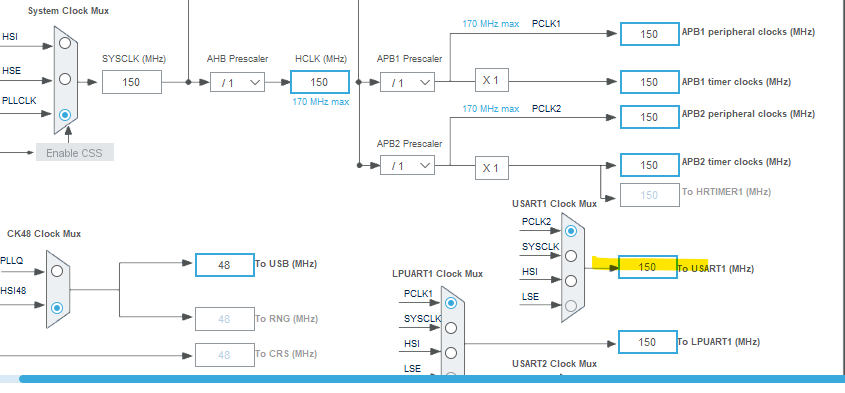

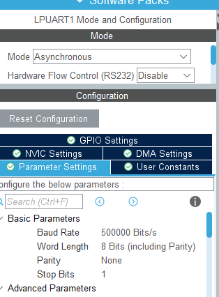

Hi everyone, I have a problem about UART_ReceiveToIdle_DMA. I receive data with baud rate 500000bits/s. I checked the reference manuel, it says stm allows to baud rate up to USART Clock/3 and my clock is 150Mhz.
Here is my problem;

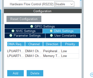

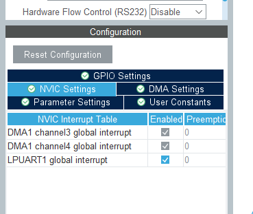

1) ReceiveToIdle_DMA does not detect Idle. I enabled NVIC and DMA settings and used RxEvent Callback. Even though there is Idle in data, it keeps receiving and writes to all buffer.
2) When I use UART Error Callback, it just receive 1 or 2 bytes. I check error flags and it almost every time gives ORE.
I searched about it and check RXNE and IDLEF flags in error call back, these are 1 every time. I don't know what to do exactly but tried to clear flags in error callback but it also does not work. Anyone have any idea?
I'd assume something else is amiss if the DMA is incorrect, or started too late. Check DMA unit status.
Perhaps implement with interrupts and get some data and timing metrics. Assume its not actually zero length, use sizeof()
