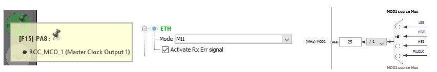

I am currently working with STM32F779 and i'm trying to obtain an IP address using the LwIP Middleware unsuccessfully.
Here are the configurations:

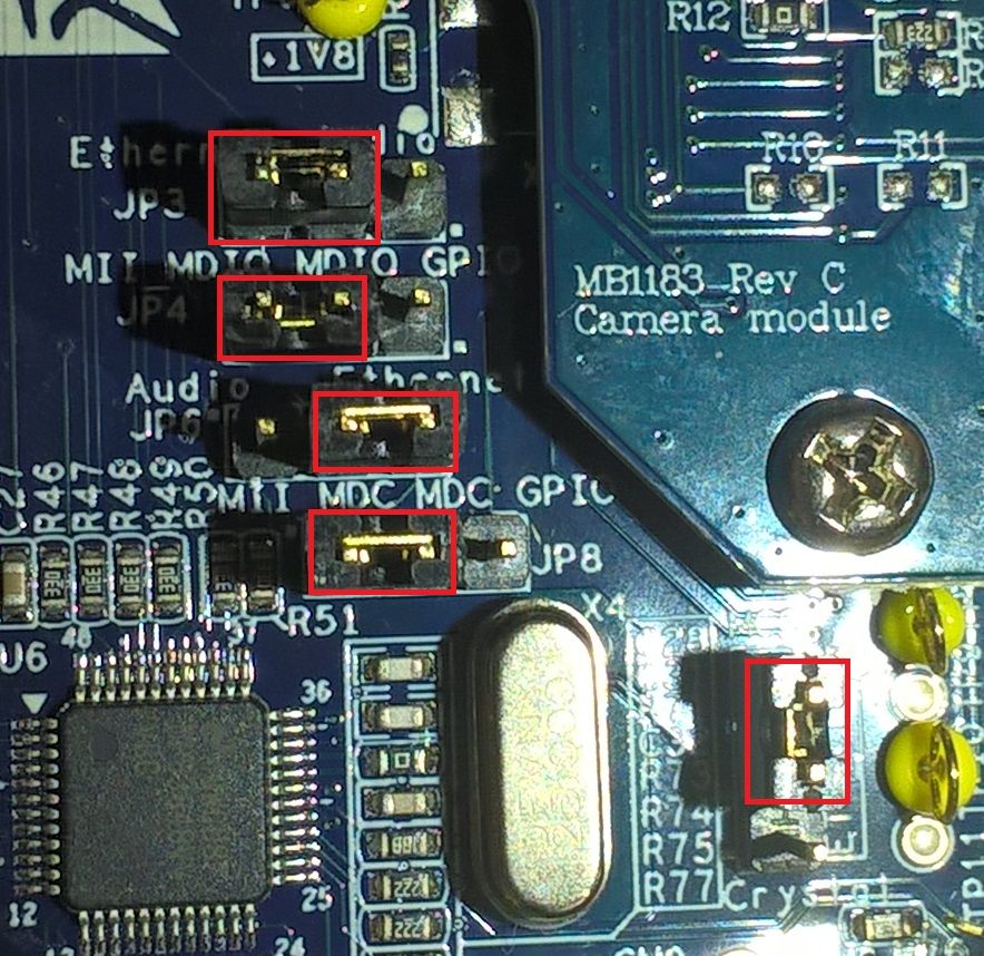

1. Change some jumpers according to the user manual page 23.
http://www.st.com/content/ccc/resource/technical/document/user_manual/group0/64/5f/b4/25/72/a8/44/d9/DM00276570/files/DM00276570.pdf/jcr:content/translations/en.DM00276570.pdf
2.  Using the STM32CubeMX, i've made the following configurations
