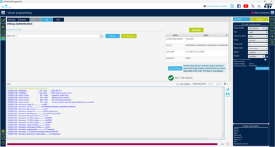

I'm working on a project with a Nucleo-H563ZI board, and did something quite dumb: went and set the PRODUCT_STATE to CLOSED from within some dummy FW, and now I'm stuck. I can see the FW is running (LED task is blinking), but now I can't seem to access the device through Debug Authentication to bring it back to OPEN.

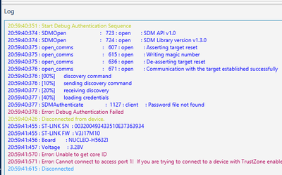

When I click on Full Regression STM32CubeProgrammer complains about "Password file not found"
Which is more than logical because I did not provide one (you can see on the first image). Since I didn't set any password, I tried passing in an empty file created by running:

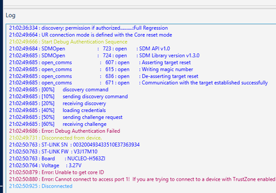

And then, it complains with:
Is there some way to run a regression? Or do I now have a pretty brick?

Yes, sadly the chip is permanently locked since you need to provision a debug authentication password or certificate (When product state is provisioning) in order to be able to regress once product state is higher.
