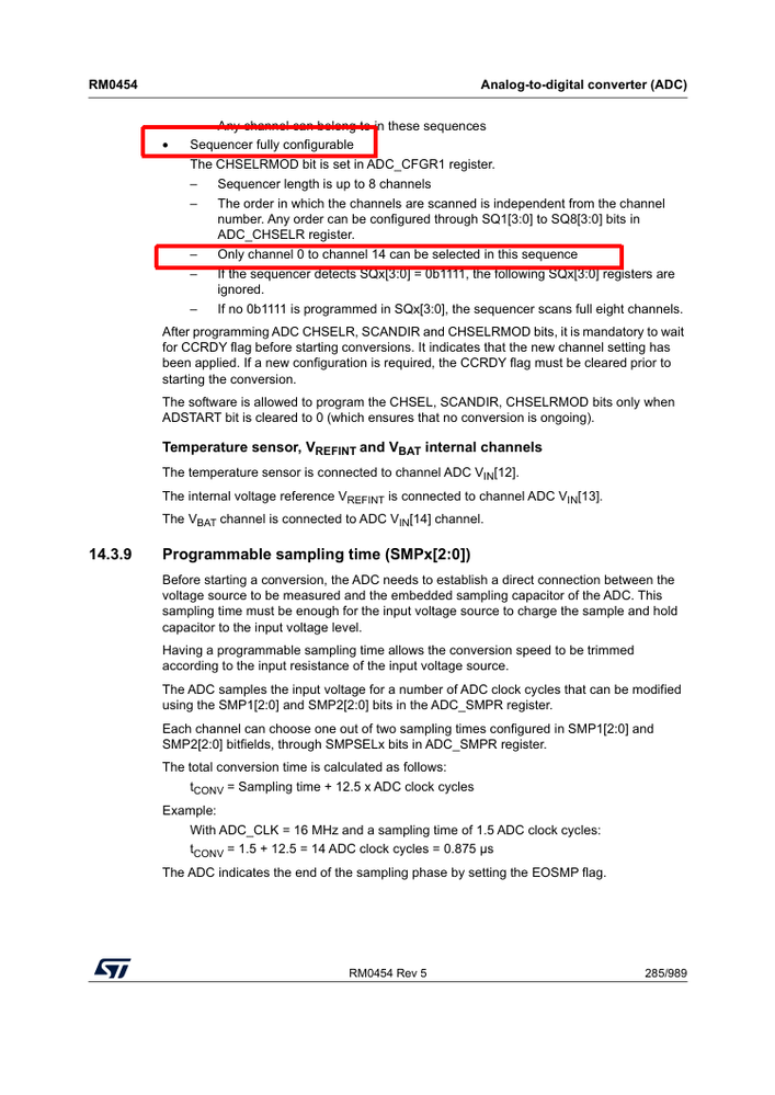

Oh, so you probably attempt to use the fully configurable sequencer mode (I don't know how is it called in Cube/CubeMX, I don't use Cube). That has this limitation, as documented in the RM (and CubeMX attempted to prevent you from going against it):

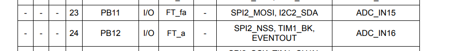

errata  https://www.st.com/resource/en/errata_sheet/es0486-stm32g030x6x8-device-errata-stmicroelectronics.pdf
shows no problem with  PB11 and PB12 pins ,
the pins should give correct ADC values :
You choose in15 and 16 ?

As you see on CUBEMX, it can not determine channel number only if PB11 or PB12 is choosen.
Even though CUBEMX cant determine channel number, I rewrite sconfig.channel as for channel 15 (PB11) and channel 16 (PB12).
/** Configure Regular Channel
    sConfig.Channel = ADC_CHANNEL_16;
    sConfig.Rank = ADC_REGULAR_RANK_1;
    sConfig.SamplingTime = ADC_SAMPLINGTIME_COMMON_1;
    if (HAL_ADC_ConfigChannel(&hadc1, &sConfig) != HAL_OK) {
        Error_Handler();
 I tried ADC poll for conversion for channel 10,11,15 and 16 seperately with this code. And the result was: channel 10 and 11 works perfectly. Even though channel 15 (PB11) is always 460 (12 bit adc max 4095) and channel 16 (PB12) is always 55. I already see voltage changes with ossiloscope on these pins, i can't see on debug.
