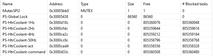

I've got a few questions about the views that show FreeRTOS Semaphores and Queues:
1.  My application creates a lot of Mutex and Queues, and only the first 63 (or 64 -- I may have lost count) of each type are visible.  Is this a feature or a bug?  And if I want to see the remainder... any thoughts on how to go about that?
2.  Here's a screenshot of the Semaphore view:
2A:  MutexSPI2 is created by CubeMX as a dynamically allocated Mutex using the CMSIS OS wrapper.
2B:  PS-Global Lock is created with
mutex_init(&lock,"PS-Global Lock");
where
int mutex_init(mutex_t *_m, const char* mutex_name) {
	SemaphoreHandle_t *m = (SemaphoreHandle_t *) _m;
	*m = xSemaphoreCreateMutex();
	vQueueAddToRegistry((QueueHandle_t) m,mutex_name);
	return 0;
I'm guessing that since the 'mutex' is being defined as a Semaphore is why it's not showing up on the list as a MUTEX, but I don't understand why the "Size" and "Free" values are.
2C: The remainder of the Semaphores are created by
	ps_queue_t *q = calloc(1, sizeof(ps_queue_t));
	mutex_init(&q->mux, mutex_name);
	semaphore_init(&q->not_empty, 0, sem_name);
 where
int semaphore_init(semaphore_t *_s, unsigned int value, const char* sem_name) {
	SemaphoreHandle_t *s = (SemaphoreHandle_t *) _s;
	*s = xSemaphoreCreateCounting(INT32_MAX, value);
	vQueueAddToRegistry((QueueHandle_t) s,sem_name);
	return 0;
I don't understand why the Free and # Blocked Tasks values are so large (other than they look like
pointers to code addresses).
The code does work (I'm using the pubsub-c library from here
https://github.com/jaracil/pubsub-c and modified it so each mutex / semaphore gets assigned
a name so I could tell them apart.
I'm trying to understand what the values mean and if they're important for what I'm using.
Yes, I should probably spend some time reading through the library but was hoping someone could
tell me if it's a feature or a bug...
I suppose the biggest question is how this view gets the info it's looking for, and if I'm
mis-interpreting the lists because it's a mutex being viewed as a semaphore, or vice versa.
Hope this makes sense to someone other than me, and thank you for your time

  1. Why only ~63–64 mutexes/queues are shown?
That’s a limit of STM32CubeIDE’s FreeRTOS awareness plugin, not FreeRTOS itself. The plugin only displays the first N kernel objects (around 64) for performance reasons. Objects beyond that still exist and work; they’re just not listed.
To inspect objects beyond that:
- Register them with vQueueAddToRegistry().
- Use the Expressions / Memory views to inspect the handle directly.
There’s no public setting in CubeIDE to increase this limit.
  • Why `Type`, `Size`, `Free`, `#Blocked` look wrong?
The issue is how you add objects to the queue registry. vQueueAddToRegistry() needs the handle, NOT the address of the variable. Passing m/s makes the registry point at the wrong memory, so CubeIDE tries to decode random data as a Queue_t, and by consequence you see huge or strange values for Size, Free, and Blocked tasks.
Correct code should be:
vQueueAddToRegistry((QueueHandle_t)*m, mutex_name);
vQueueAddToRegistry((QueueHandle_t)*s, sem_name);
  • Are those values important?
They’re debug info only:
- For a mutex/binary semaphore: Size = 1, Free = 0/1.
- For counting semaphores: Size = max count, Free = current count.
- # Blocked tasks helps diagnose contention.
They don’t affect runtime behavior; wrong values just mean the debugger looked at the wrong memory because of the registry bug, not that your synchronization is broken.
