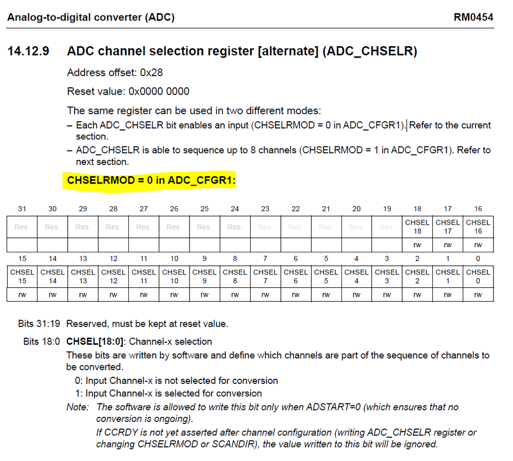

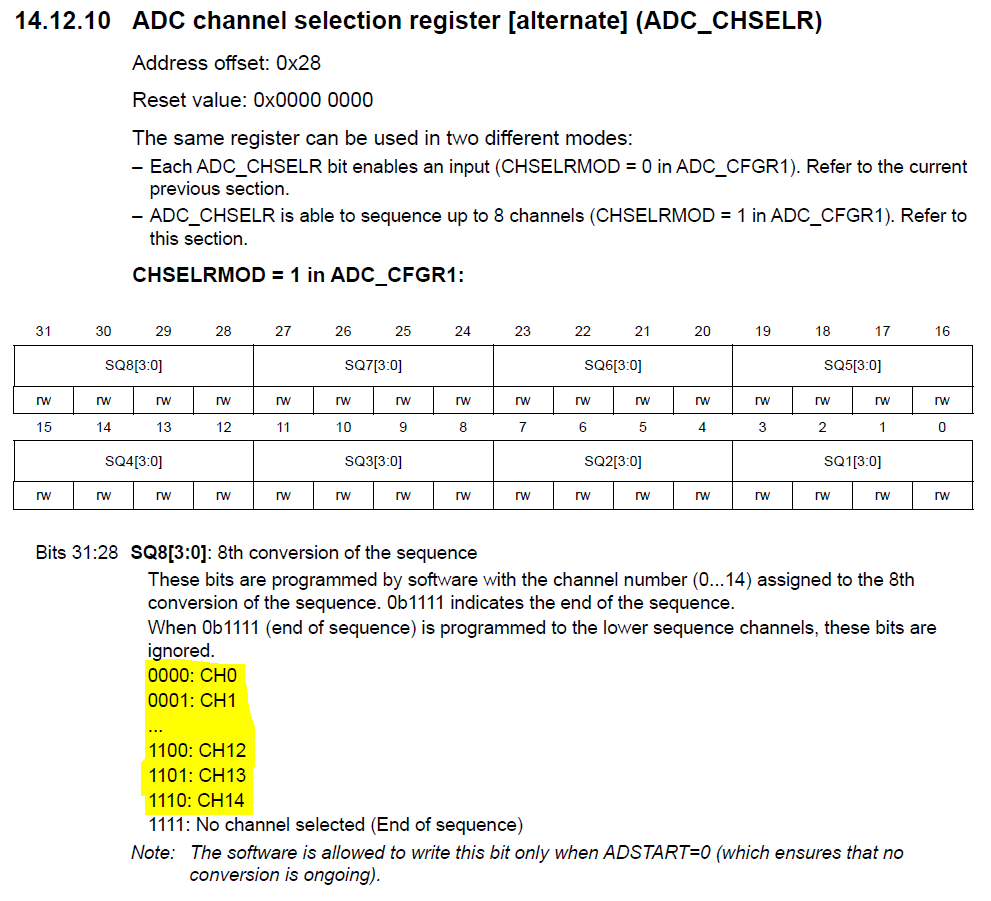

Aug 11, 2020 12:37 UTC
Check your CHSELRMOD bit. If it's 1, only channels 0-14 may be selected for regular conversion.
If it's 0, you can select any channel.
MFaiz.2
MFaiz.2Author
Aug 11, 2020 14:21 UTC
CHSELRMOD_bit is 0 as shown in screenshot
 As you can see, channel_15 value is exactly same as channel_3 value because it is read before channel_15.
If I disable all other channels and only enable channel_15 then it will read exact 0.
Interesting point is all HAL functions return OK status.

Aug 11, 2020 13:54 UTC
It’s the first time I’m seeing it. It is certainly not in the families I’ve used a lot in the past. F4, H7
I first tried to set it up in CubeMX and it reported an error, so I investigated the reference manual.
Aug 11, 2020 14:27 UTC
> I have used CubeMX, though it didn't give me any error. Original project files are attached with question
Your project only converts a single channel, channel 3. The error is not in the CubeMX generated code, it's in the user code you added.
Channels 1, 15 and 16 are set up as inputs, but they're not actually part of the conversion in your project.
