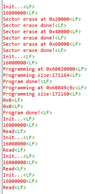

The following image is a log generated by the external loader. The lines "0x3401<LF>" and "0xb510<LF>" is the data I was checking to see if there's corruption or not. The correct lines should be "0x0<LF>"
Removing HAL_NOR_Program from the Write function, there's no corruption data. Also using an old memory compatible with this actual there's no corruption.
Another strange thing is if I use the external loader with the old tool StLink Utility also there's no corruption. The only thing I can see is there is only one call of Write function instead of 2 times in CubeProgrammer. The following image is the log generated by external loader when StLink Utility is used

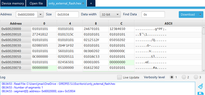

I've made a linear binary starting from 0x60020000 and 342324 bytes to program.
 At the first impression, seems it programs what is expected because both address 0x6004EE80 and 0x6004EEA0 tries program 0x0, which the correct value.

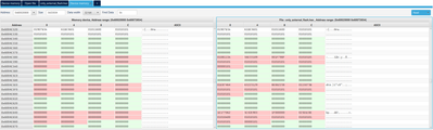

But if I do a comparison between memory and file there's a lot of regions with a wrong data. The first wrong occurrence was in the address 0x6004C580 but it changed every time I tried to program. Anyway always was when Write function was called in the second time.
There's attached the log generated from CubeProgrammer with verbose 3 to help a more deep diagnostic.
