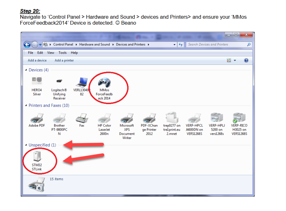

Hello, I have an STM32F407G-DISC1 and it has not been fun. when I try to plug it into my PC it always goes to Unspecified in Device and printers. i have tried this on 2 pcs ant the same thing happens. Thank you if you read this!

‎2019-02-19 5:09 PM
Step 20 of your posted PDF document shows the STLink in same location :)

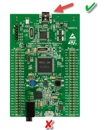

Which end of the DISCO board are you trying to connect to PC?
‎2019-02-19 12:49 PM
Very good call @Community member​, the MINI USB connector (larger one of the 2 on this kit) MUST be used to develop with the kit. Then you should see the enumeration of the ST-Link front end tool.
‎2019-02-19 1:25 PM
I am using the mini usb port
