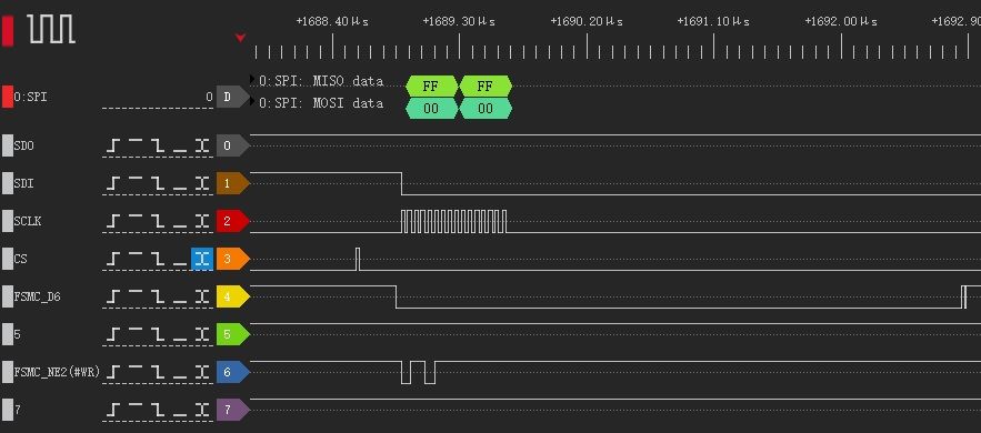

Basing on the lastest "STM32F4xx_StdPeriph_Driver" to Read SPI data and then write into external FSMC(8bit) device in the PWM interrupt like following .
void TIM2_IRQHandler(void)
SPI1->DR = 0; // SPI_InitStructure.SPI_DataSize = SPI_DataSize_16b;
FTadd = Word_Upload++; // #define FTadd (*( uint16_t *)0x64000002)
TIM_ClearITPendingBit(TIM2,TIM_IT_Update);

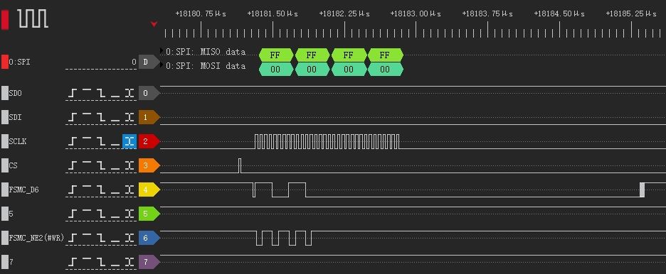

But from the LA waveform below, both SPI clock and FSMC #WR ops doubled.FSMC init as following

This is probably the interrupt being executed twice, due to late flag clear.
‎2021-01-08 6:32 AM
‎2021-01-08 11:24 PM
Thank you, JW. You SHORT words exactly shot it. When doing the following change, the problem is gone.
Got the following form.thanks again and like this community!!! :D
