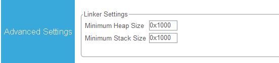

I took a look at the issue and found that:
  1. In the usbd_cdc.c, USBD_CDC_Init() is using this value to allocate memory: USBD_malloc(sizeof(USBD_CDC_HandleTypeDef));
  2. the USBD_malloc is by default using malloc of the compiler... which means it takes heap.
  3. I checked my default linker directive and found the heap size is 0x200 (512 bytes)
  4. This is certainly going to cause trouble....and lucky me only run into a USB error not other issues....
If you do not like the solution to change the CDC_DATA_HS_MAX_PACKET_SIZE from 512 to 64 (like me...), you can enlarge the heap size by modifying the link directive file.
In my case, I am using IAR, I changed heap to 8KBytes:
define symbol __ICFEDIT_size_heap__  = 0x2000;
