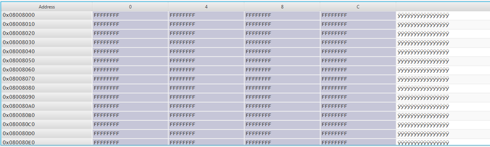

Hi community..
I have the following code :
bool FLASH_WriteDoubleWord(uint32_t flashAddress, uint64_t Data)
	FLASH_Unlock();
	/*clear some flag*/
	 __HAL_FLASH_CLEAR_FLAG(FLASH_FLAG_EOP | FLASH_FLAG_OPERR | FLASH_FLAG_WRPERR | FLASH_FLAG_PGAERR | FLASH_FLAG_PGSERR );
	//FLASH_Erase_Sector(2, 2);
	/* Program the user Flash area word by word */
	if (HAL_FLASH_Program(FLASH_TYPEPROGRAM_DOUBLEWORD, (uint32_t)&flashAddress, Data) != HAL_OK)
		FLASH_Lock();
		return false;
	FLASH_Lock();
	return true;
where
static uint32_t     address_test = 0x08008000;
static uint64_t     data_test    = 0xAAAAAAAA;
I don't understand why the erase part is working instead HAL_FLASH_Program it is not writing the data in the expected address.
Can you please tell me why in your opinion?
Thanks a lot.
Simone

Yes... The function is returning an error... I will try to print out the flags status
SGasp.1
Senior
i tried in this way
	FLASH_Unlock();
	FLASH_EraseSectors(2, 1);       /*working*/
	HAL_Delay(500);
	FLASH_Unlock();
	HAL_Delay(500);
	if (HAL_FLASH_Program(FLASH_TYPEPROGRAM_BYTE, (uint32_t) flashAddress, Data) != HAL_OK)   /*not working*/
		Turn_on_red_led();
		FLASH_Lock();
		return false;
	FLASH_Lock();
	return true;
Now I don't get the erro from HAL but when I check the flash the values is not written as expected.
