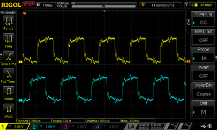

Thanks for the reply. I am using inexpensive (Sino) linear scales as inputs. I get nice crisp square waves on the input while moving either scale.
With HCLK set to max (84Mhz) the output is very jagged with slopes on the rise and fall and more of a peak than a flat line at the top of the wave. It looks more like a noisy sawtooth wave. I don't recall how fast the signals are when seeing this.
With the HCLK set at 4Mhz I get the expected vertical rise and fall and a nice square wave. When I see this the output the time between rise and fall is in the 10-20 microsecond range which anecdotally "feels" right when observing the DRO - no lag and no missed steps.

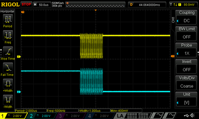

Reading from the scale (5v):

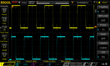

Output with HCLK at 4Mhz. DRO reads this fine:

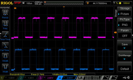

Output with HCLK at 84Mhz. This is much cleaner than what I previously could get however the DRO still cannot read this:
My working theory is that the frequency of the last output is too high for the DRO to read. How can I rate limit this output to ~20Khz or so without setting HCLK to a lower value? Or is setting HCLK to a very low value an accepted solution?

 I should also mention that despite moving the scale at a steady rate, the output seems to be grouped in small blasts of signal.
The DRO should have a maximum "velocity" it supports. Likely it's not set up for an edge ever microsecond.
Put a small delay in the main loop after the signal is changed. Use a timer at max frequency and ensure the delay is at least X us long. That will ensure the edges are stable for at least X us.
