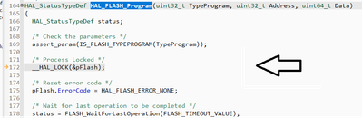

I am diving into the function FLASH_WaitForLastOperation. The error code is 160 and it returns HAL_ERROR.

I am going to check what is this 160 error code.
Calling HAL_FLASH_Program at the start of the program can interfere with the debugging process. When you upload a new program, it resets a few times before the debugger starts. Otherwise, it works as described.
Just clear error flags right before flashing. Also it would be good to check carefully what is going on inside flash_erase_page_by_address. It seems there is something messy inside. I'd check the error flags after it finished.
Good idea!
There is a way to detect when this process is over? Thanks again.
The pFlash.ErrorCode is 0x80 therefore, yes, there has been an error related to the flash.
How do I solve it?
