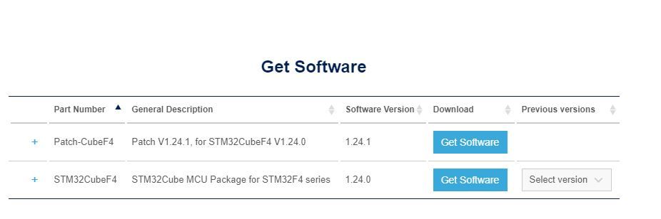

> The latest released version of STM32F4 HAL is v1.24.1,
Where is it available? the download page still shows 1.24.0
thanks,
- pa
‎2019-05-20 6:14 AM
You are right, the patch is not available on the ST web page. I will raise this internally for fix.
You can download the patch STM32CubeF4 v1.24.1 from STM32CubeMx.
Thanks
Imen
‎2019-06-13 7:14 AM
The patch STM32CubeF4 V1.24.1 is now available on the ST web page.
Best Regards,
Imen
