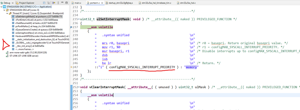

I'm working on a project based on STM32F479 and FreeRTOS. In this project the microcontroller is connected via I2C and SPI bus to other devices, such as switch ethernet and spi-uart converter. I run the initialization of these devices before the start of the FreeRTOS scheduler. Startup procedure requires switching some GPIOs and waiting a few milliseconds as described in the devices datasheet. I've manged the waiting part of the initialization using the HAL_Delay function. This project has been generated in 2019 with STM32F4 fw package 1.24.0 and an old version of STM32CubeMX.
Recently I've created a new project for the same hardware using fw package 1.28.0 and STM32CubeMX 6.11.1. I noticed that the initialization of TIM6 in stm32f4xx_hal_timebase_tim.c has been updated and HAL_InitTick function is changed (which you can find in the attachment). Now I'm experiencing a strange behaviour. During devices initialization the program remains stuck in the HAL_Delay function. Apparently TIM6 interrupt is not running before the start of the scheduler, so the global variable uwTick is not incremented and as a result HAL_Delay waits forever. I had to move the initialization of the devices after the start of the FreeRTOS scheduler to solve the issue.
Can anyone help me figure out what I'm missing?

@Pavel A. Yes, That is how I found the casue of HALTick not running. I could not find use of CMSIS::__set_BASEPRI() anywhere in my code, but there is a static allocation of FreeRTOS semaphore in MJPEG static instance i.e. before main(). Thanks for a hint.
