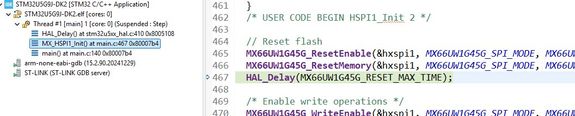

Hi @MGall.11
I experienced the same issue when migrated from FreeRTOS 1.0.1 to 1.5.0 (CubeMX 6.17 example STM32U5G9J-DK2-3.0.7.tpa).
CubeMX changed priority of TIM6 to 15 and my previously working Gfx demo stopped working. After i changed TIM6 prio to 0 the demo worked again.

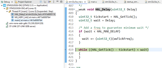

As explained by LiteYear, it depends on how the system is configured with STM32CubeMX. In my case, I have the TIM6 timer interrupt set to 1 ms, which increments the HAL tick, and the FreeRTOS tick interrupt is handled by the SysTick_Handler IRQ (xPortSysTickHandler) with priority set by configKERNEL_INTERRUPT_PRIORITY. The number of ticks per second is defined by configTICK_RATE_HZ. All of this is configured in xPortStartScheduler.
>> "But wanted to confirm my understanding: in the old HAL implementation the systick priority was 0 and in the new implementation the priority is set to 15 which is not working, and setting it to 0 works again?"
Exaclety. TIM6 prio has changed to 15 (was 0) and with that change, HAL_IncTick() is not called.
As soon as i set TIM6 priority to number 4 or less, the system works. So it seems it has sth to do with that number 5 that sets boundary between "RTOS aware IRQs" and the "rest". I am trying to understand what is masking the TIM6 IRQ. The RTOS initialisation is executed only after HAL modules initialisation so it is not RTOS, I think.
With TIM6 IRQ priority set to 5(or higher), my program waits at delay and HAL_GetTick() returns always 0.

@MGall.11
In you main(), before anything else, try to call __set_BASEPRI(0)
int main(void)
  /* USER CODE BEGIN 1 */
  __set_BASEPRI(0);
  /* USER CODE END 1 */
Something can call a function that internally uses a RTOS lock (for example, malloc) while the scheduler is not started yet. For FreeRTOS, in some configuration, these locks raise BASEPRI.
