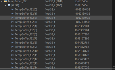

Hello, I am trying to record MEMS microphone data using STM32F4-DISC board. I used BSP and CMSIS-DSP libraries to gather data and calculate FFT of recorded signal. I save my recordings in
static q15_t TempBuffer[2048];  and I want to cinvert this buffer to float32_t type to pass it to  arm_rfft_fast_f32() func. I was trying to use this function arm_q15_to_float(TempBuffer, TempBuffer_f32, 2048); but the results are way off. TempBuffer values are going from 3276 to -3276 but after converting  it to  float, I get very large values (around 100000 larger), and after calculating FFT I get very large FFT amplitude values. I try to record Sin wave of a 1Khz. In TempBuffer I can see fluctating values, but FFT doesn't show any peaks. Any ideas how to correctly should I convert data? I will add  code where all the conversion is taking place:

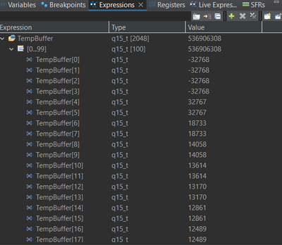

In i16 space q15 will span 32767 to -32768 which should translate to +1.0f to -1.0f in float space.
Your illustration / explanation is going to work a lot better if you dump the bytes in memory so this can be replicated.
DSimp.1
I will add variable values, maybe that would help:
