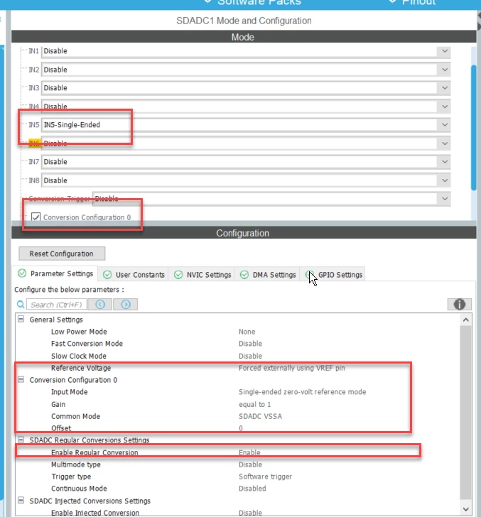

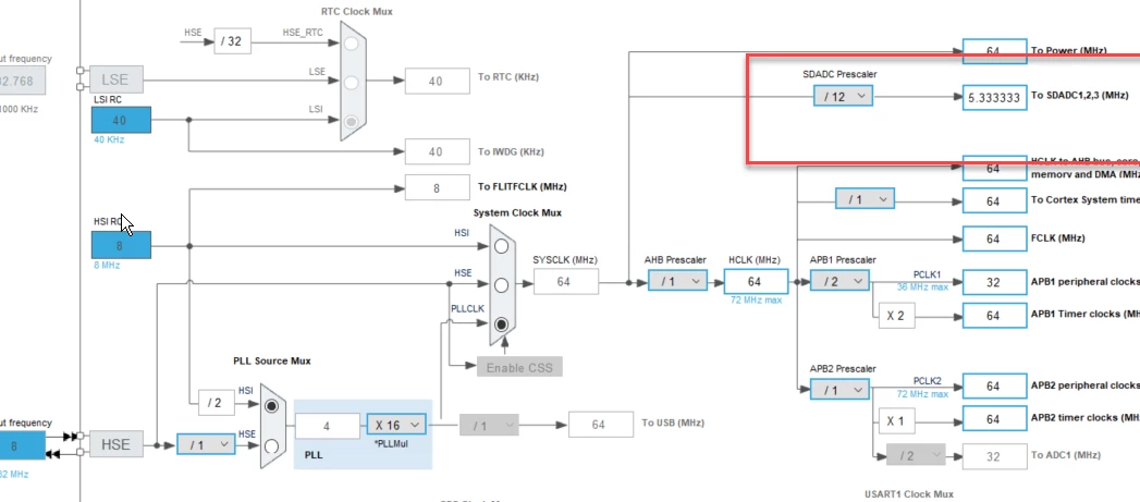

Hello guys,
 I tried to use the HAL_SDAC functions to read two Analog signals (0-3.3V) with DMA but I didn't have good results.
That's why I started reading only one Analog signal in Polling mode (ING 5)....unfortunately even in this case I always read zero (AD_result=0)
I am using the STM32F373 and STM32CubeIDE.
Any good ideas?
My configuration:
The code in main.c:
MX_SDADC1_Init();
HAL_SDADC_CalibrationStart(&hsdadc1, SDADC_CALIBRATION_SEQ_1)
HAL_SDADC_PollForCalibEvent(&hsdadc1, 10);
HAL_SDADC_SelectRegularTrigger(&hsdadc1, SDADC_SOFTWARE_TRIGGER);
HAL_SDADC_AssociateChannelConfig(&hsdadc1, SDADC_CHANNEL_5, SDADC_CONF_INDEX_0) ;
HAL_SDADC_ConfigChannel(&hsdadc1, SDADC_CHANNEL_5, SDADC_CONTINUOUS_CONV_OFF);
HAL_SDADC_Start(&hsdadc1);
while (1){
HAL_SDADC_PollForConversion(&hsdadc1, 100); // Poll ADC1 Peripheral & TimeOut = 1mSec
AD_result = HAL_SDADC_GetValue(&hsdadc1); // Read ADC Conversion Result

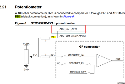

I am using the ST demo board STM32373C-EVAL and the PB1 GPIO pin with the potentiometer.
The Vref is good..:grinning_face:

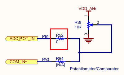

mƎALLEm
May 15, 2024
Check R52 0 ohm resistor,  already soldered?

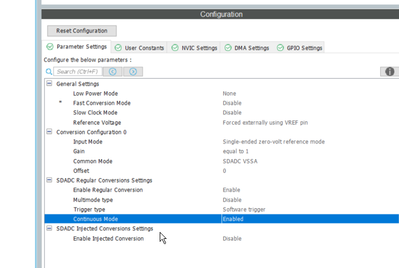

May 16, 2024
news...it seems if I do START and STOP of conversion whenever on the while loop the AD_result  is changing
while (1){
HAL_SDADC_Stop(&hsdadc1);
This even though I put continuous mode ENABLE:
Now I'll drop this example in polling and try again to read 2 Analog signals (0-3.3V) with trigger timer and DMA.
In this mode (2 channels)  the only via in to use the injected conversion...correct?
VeroAuthor
May 17, 2024
news... 2 analog signals ( injected conversion mode) with trigger software (no timer) and NO DMA is working....

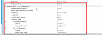

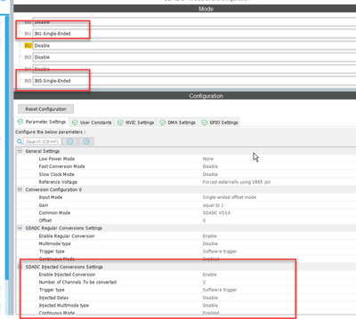

VeroAuthor
May 17, 2024
The configuration for the previously example (2 analog signals ( injected conversion mode) with trigger software (no timer) and NO DMA)
