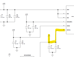

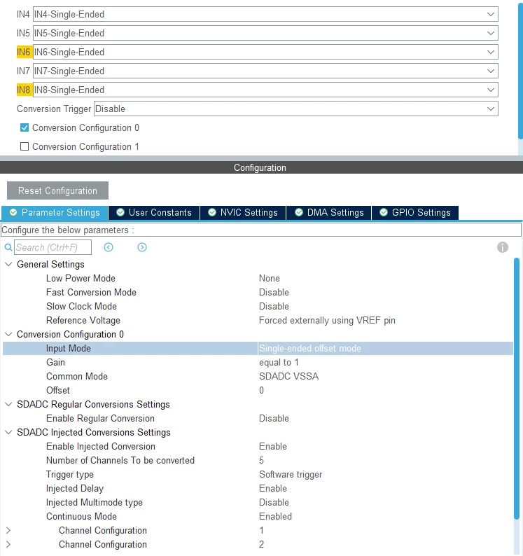

Hi all,
I am trying to activate SDADC on my custom designed board to measure a couple of analog voltages.
I am trying to measure 5-channels in injected continuous mode. Offset = 0, Gain = 1, Single-Ended Offset Mode. See the CUBE settings below :
In the code, I initiate the conversion by the following :

The thing is that all outputs are 32767. Channel number changes correctly so I think SDADC is successfully making some conversions.

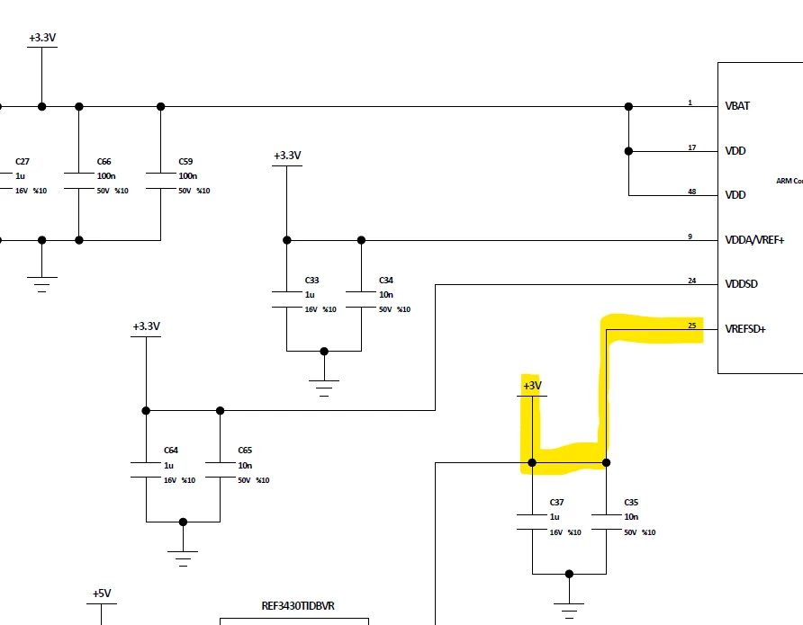

As for the HW side; I measured all five voltages on my board and they are all OK and under the SDADC limit. I have voltages varying from 1.5V to 2.6V.
I am using a precise 3V at the VREFSD+ input and all other supplies are connected to 3.3V. I measured my reference voltage and it stands exactly at 3V. See below the power supply schematic :
Since I could not see anything wrong on the HW, I lean more towards this being a SW issue.
I would really appreciate if you could shed some light on this. I am mainly a HW guy who is doing firmware for diagnostics purposes so it is likely that I am missing a crucial step somewhere.
