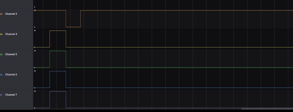

Hello @waclawek.jan
i have used logic analyzer and figured out that there is no clock.
Here is a capture of the SPI2:
The only toggle is when i reset the bluepill.

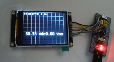

Yes - i have just now a small 2,2" TFT on SPI2 running, on a "blue pill" board.
How you set the spi2 in Cube ?  ed , ok i seen it.
I have it at 18Mbit...and using CubeIDE .

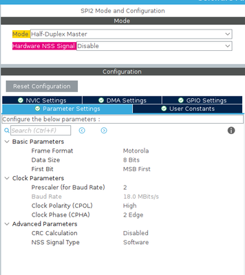

@AScha.3  thanks for for your reply.
can you please share your STM32CubeMX settings?
@Andrew Neil  thanks, i will do that surely

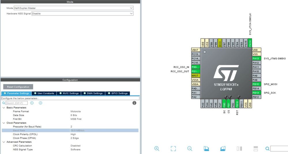

My spi2 setting:  (+ pin speed: high )

Yes , core at 72 M.
CS.. are just any I/O pins, that are close (for wiring...i hate, to have a wire cross the board. :) )
hamo
Senior
@AScha.3  i have just tried this settings and compiled the code and uploaded, it stills not working for me.
I used the logic analyzer -> all the pins (SPI2) are not toggling.
