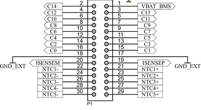

I am trying to use the AEK-POW-BMSWTX to read cell voltages from an Optipower OPR50006S50 Lithium Ion battery.  I only want the cell information, not interested in battery management itself.  I'm using SPI2 from an STM32G474RE.
I have spliced pin C0 to the GND EXT pins and the GND terminal of the battery, then used C1 through C6 for cell wires. C6 is spliced to C7 through to C14, finally the positive terminal of the battery is connected to VBAT.
The issue I am finding despite no MISO comms from the board is LED D2 goes off after 60 or so seconds.

Hello @IPrin.1 ;
I advise you to consult the AEK-POW-BMSWTX documentation for LED D2 status meaning.
Could you please double check all the wiring and SPI settings.
Thank you.
Kaouthar
Pavel A.
Maybe you need to raise CS after the wake sequence and lower CS again before the HAL_SPI_TransmitReceive loop? or add delay after the wake sequence?
