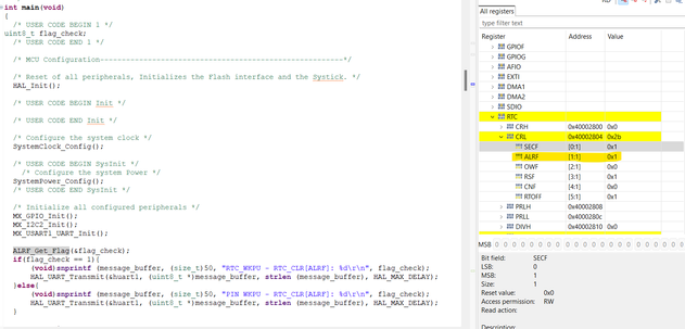

In this thread, I would like to clarify a point regarding how to read the RTC_CLR[ALRF] flag. I am using the STM32F103C8T6 microcontroller and the STM32Cube Firmware (HAL) version 1.8.5. This flag indicates that the alarm has been activated.
My intention is to determine the reason for the system reset, as I have configured two ways to exit the STANDBY mode before enabling it:
1. Through the wakeup pin.
2. Through the activation of the alarm.
To achieve this, I am trying to read the RTC_CRL[ALRF] bit after returning from STANDBY mode and executing the functions HAL_Init(); and SystemClock_Config(); The result I obtain is somewhat curious. When the debugger is connected (Stlink V2), the flag is correctly activated after the system reset. However, when I disconnect the debugger and perform logging through UART, the bit never gets activated, even though it is the alarm that causes the system reset.
I have created my own function to read the register following the instructions I´ve found on the reference manual and on AN2629, and it must be executed before the function MX_RTC_Init(); generated automatically by the STMCUBE IDE. This is because MX_RTC_Init includes the HAL_RTC_Init function, which clears the ALRF flag during RTC initialization.

My solution to this problem is as follows:
After a system reset following a return from STANDBY mode due to a rising edge on pin PA0 or the activation of the RTC alarm, we can read the PWR_FLAG_SB flag using the macro: __HAL_PWR_GET_FLAG(PWR_FLAG_SB). This way, I can confirm that a reset has occurred. To determine the cause of the reset, I read the current time and compare it with the time I had set for the alarm (previously saved in backup registers or flash memory). If both times are equal, the reset reason is the RTC; otherwise, it's the PA0 pin. This solution works, but in my opinion, it may not be the best one.

Best answer by Cgelectronics
Hello @Piranha
Thanks for your answer, I would like to complete my response since my comment does not sufficiently clarify the solution to this thread. Here is the necessary information:
The ALRF bit is part of RTC_CR register, not ALR - this can be seen e.g. in the figure just above, the paragraph from the reference manual i´ve posted. And this register is not part of the backup domain.
When debugging during this time, then the MCU is not really in standby - the debug enable bit is active. This means that the core is still clocked along with all the registers and thus they are not reset. In normal conditions, debug does not provide power / clock to the core and peripherals.

 After many attempts and tests, I have opened a ticket with ST, and this is the answer to this topic:
"It turns out that the ALRF flag (and indeed the whole register) is not kept through system reset - which occurs at wake up. Although this is not explicitly documented. The only similar flag that is kept is WUF in PWR_CSR register but this is combines wakeup from button and RTC alarm so not helpful in your case.
The solution is then the one you already applied - compare the current time to a predefined one from Flash/backup registers."

As can be seen even in your screenshot, the RM0008 section 18.3.2 "Resetting RTC registers" documents the reset factor very clearly:
All system registers are asynchronously reset by a System Reset or Power Reset, except for RTC_PRL, RTC_ALR, RTC_CNT, and RTC_DIV.
There is no RTC_CRL register in the list of exceptions, therefore it is reset and it is documented. But, of course, ST's support stuff also cannot see it...
