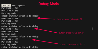

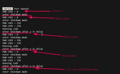

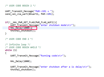

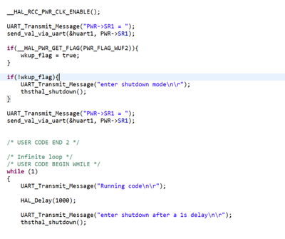

Hello @Sarra.S ,
here is my code :
And this is what I get when I am in debug mode :
when i am not in debug mode :
and this is my shutdown function :
The first thing is that it seems like everything is working right in debug mode, but in non-debug mode, when I press the button (a short press), the device goes to shutdown and wakes up whith just one press.
However, when I do a very, very short press, the wakeup flag is false (PWR->SR1 = 0).

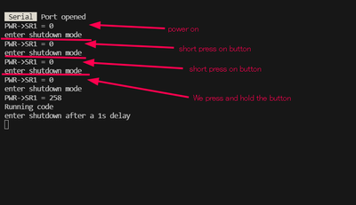

So, we added a delay before going to shutdown to see what we get :
This is what we get:
- When I do a short press, the PWR_SR1 equals 0 and the device goes to shutdown.
- When I press the button and keep it pressed, the PWR_SR1 equals 0. After 1 second, it goes to shutdown, and after that, the device wakes up, and PWR_SR1 equals 258.
Thank you.

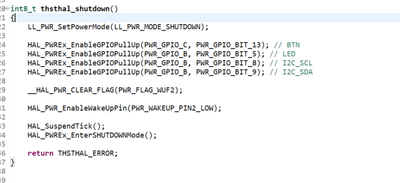

Primary you cant activate WUpin when is LOW, then add chcek to release before ...
ouss_mans
hello @MM..1 ,
I changed my shutdown function to this:
int8_t thsthal_shutdown()
	LL_PWR_SetPowerMode(LL_PWR_MODE_SHUTDOWN);
	__HAL_RCC_PWR_CLK_ENABLE();
	HAL_PWREx_EnableGPIOPullUp(PWR_GPIO_C, PWR_GPIO_BIT_13); // BTN wkup pin 2
	HAL_PWREx_EnableGPIOPullUp(PWR_GPIO_B, PWR_GPIO_BIT_5); // LED
	HAL_PWREx_EnableGPIOPullUp(PWR_GPIO_B, PWR_GPIO_BIT_8); // I2C_SCL
	HAL_PWREx_EnableGPIOPullUp(PWR_GPIO_B, PWR_GPIO_BIT_9); // I2C_SDA
	HAL_PWR_DisableWakeUpPin(PWR_WAKEUP_PIN2);
	HAL_PWR_EnableWakeUpPin(PWR_WAKEUP_PIN2_HIGH);
	__HAL_PWR_CLEAR_FLAG(PWR_FLAG_WUF2);
	HAL_SuspendTick();
	HAL_PWREx_EnterSHUTDOWNMode();
	return THSTHAL_ERROR;
and when I retrieve the value of `PWR->SR1`, it's always 0 when I press the button, although it should be 2.
