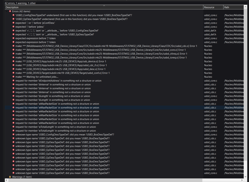

i have problem to compile STM32Cube_FW_F7_V1.17.0\Middlewares\ST\STM32_USB_Device_Library
I use STM32CubeIDE Version: 1.14.0 + STM32CubeMX Version: 6.10.0-RC9
chip STM32F767ZITx  (NUCLEO-F767ZI)
I'm mainly interested in the cause

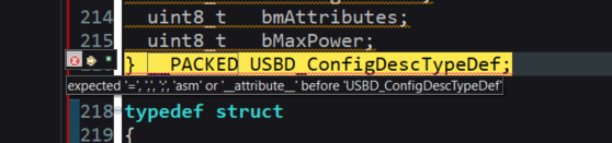

expected '=', ',', ';', 'asm' or '__attribute__' before 'USBD_ConfigDescTypeDef' usbd_def.h

Looks like it's not recognising the "__PACKED" there.
