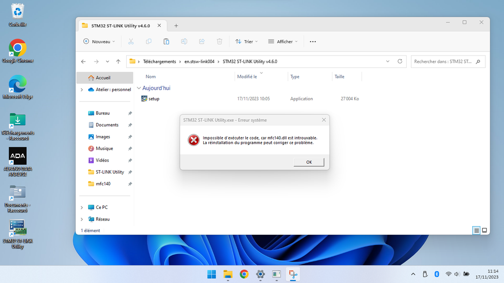

I have a new PC Windows and and I have this error when I start the software STM32 ST-LINK Utility (file in attachment)
It misses dll file (mfc140.dll)
And idea please?
Thanks
Arnaud
Solved! Go to Solution.

I think that I have found the problem, it misses all .DLL file in my computer , I need to download Microsoft visual c++ from the last years on the PC.

Hello @Arnaud1
I've tested and it works with no problems for me. I think the problem is related to your own environment.
I suggest you to:
- Ensure that you are using the SW from ST website.
- take a look at your internal configurations.
PS:
- I personally recommend you use the STM32CubeProgrammer. STM32 ST-LINK Utility is Not recommended for new design.
- This can also be visual studio issue. It happens sometimes when the OS is not fully updated and
you mentioned having a new windows PC.
Best Regards.

Microsoft Visual C redistributables are needed for several tools, Microsoft doesn't install them by default, and doesn't want tool vendors to introduce their own .DLLs all over the place.
My go-to resource for this issue is https://www.techpowerup.com/download/visual-c-redistributable-runtime-package-all-in-one/
