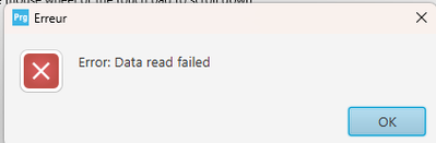

I work on a STM32F042G6Ux mounted on a custom board, and I want to automatize the flash by using command line and STLink (I'm using V2-1 one).
STM_CLI works well to unlock the reading, unfortunately I read that ST won't deploy it on ARM architecture, and I want to work on Raspberry Pi.
That's why I decided to use OpenOCD (v0.12.0) to flash my STM32. However, there's a problem using it : I have to switch power supply to apply the changes on the option bytes. I want my command line fully automated, and this is problematic.

When I connect with STMCubeProgrammer, I have this error (normal , read is protected) :
But when I read Option Bytes, RDP =0xAA!
I strongly suspect the Hardware didn't work on openocd, even if I configured it with "reset_config srst_only srst_nogate".
How can STM_CLI can do a good HW reset and not OpenOCD?
The wires connexions are the same for STM_CLI and OpenOCD, and it's SWD connexion ones : SWDIo, SWCLK and SRST are connected. I used SWD connexion in both OpenOCD, STM_CLI and STMCubeProgrammer.
