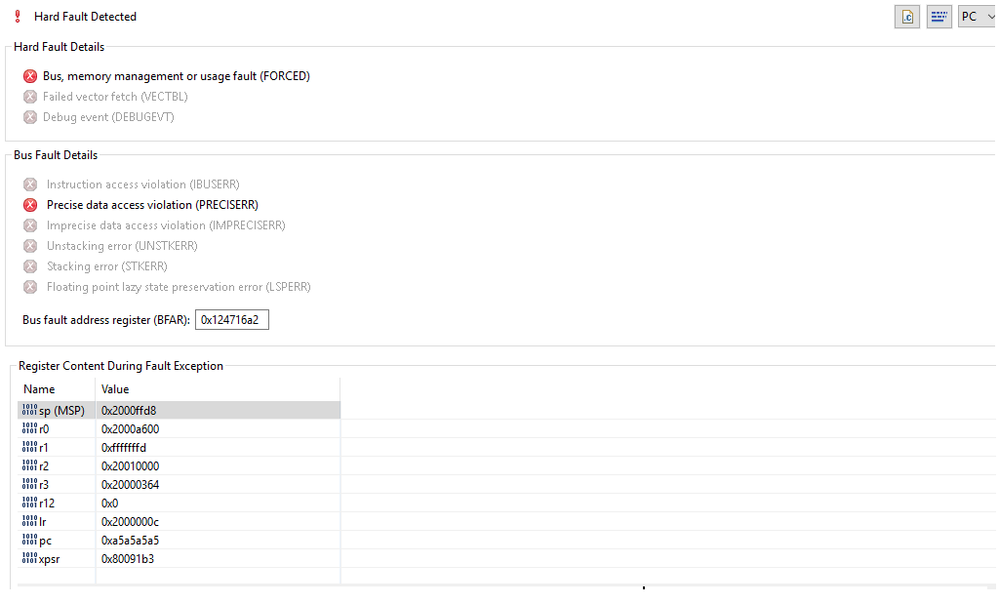

I am trying to implement PTP (IEEE1588) on stm32f107 I have used this code for reference
"https://github.com/mpthompson/stm32_f4_ptpd" and ported it to stm32f107
Now, Everything works fine if Time stamp register bit 0 is set to "0" ,i.e..
I can see the sync and announce packets in wireshark and the program is running with 0 timestamps , below attached is the debug2 for reference.
if Time stamp register bit 0 is set to "1" program halts with hardfault. with below debug 1 and attached is the image of what fault analyzer has to say.
Thanks For helping ...0693W000000UpfUQAS.png.

I am using stm32cubeIDE generated code with FreeRTOS(CMSIS V2) and LWIP.
Third line here is what is causing hardfault.

The PC/LR values in your prior post don't look valid/helpful.
Hard to diagnose with info presented. Might want to check the stack sizes, or try without the RTOS.
You need a proper Hard Fault Handler, and you need to look at the offending assembler instructions and processor registers.
See routines here that can provide more actionable data
https://community.st.com/s/question/0D50X0000BxwhEhSQI/my-stm32h743vi-application-runs-to-a-debug-instruction-in-the-startup-code
You then need to disassemble the failing code, or make a determination if the failure flags on more random locations.

Looks like ethernet driver is the problem.
Is there a working HAL_ETH driver for PTP applications for STM32f107 ?
