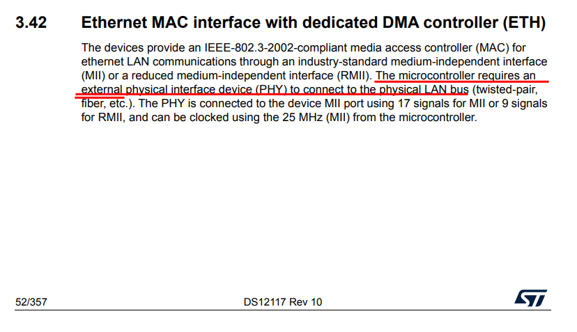

@shivangiupadhyay wrote:
how to implement ethernet on stm32h753zi mcu (with onboard phy)
The stm32h753zi does not have an onboard PHY:
https://www.st.com/resource/en/datasheet/stm32h753zi.pdf#page=52
via: https://www.st.com/en/microcontrollers-microprocessors/stm32h753zi.html

The boards are the same, the only difference between STM32H743 and STMH753 is the crypto not used by the ethernet. So the example on Nucleo-H74should work on Nucleo-H753.
