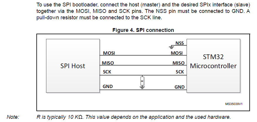

I made a firmware download project using a factory bootloader according to AN4286. Everything works fine.
I have only one ambiguity - in the description of the bootloader in AN2606 there is a picture on which the SCK signal is pulled-down to the ground and in the description it is written that there must be a 10k resistor.
Please explain the need to use a pull-down of the SCK to the ground.
Is it possible to do without it?

If you don't connect a pull-down to SCK and, for example, boot into the bootloader without a host connected, the sensitive SCK input will interpret noise as a clock and the bootloader may assume you have a host connected.
With the pull-down connected, there will be no activity without host and the bootloader can continue to scan the list of possible interfaces.

If you can ensure SCK is driven low while the target is in bootloader mode, it is not needed.
