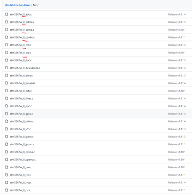

Hello all,
I am using STM32H747 in my project, previously I was using HAL library for my project, but now I want to shift my code to standard peripheral library, my question is do STMH7 series support to standard peripheral library if Yes then can anyone share me the SDK for the same
Thanks!!!!
mÆŽALLEm
Hello @tobbymathew ,
There is no SPL library for H7. If you mean by that using low level driver you can use LL implementation available in HAL:
But not all peripherals have this implementation: FDCAN as an example.
