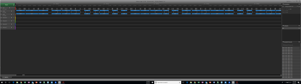

Hello, I'm working on a project involving STM32L476RG Microcontroller. I'm trying to write a piece of code for creating an SPI Driver for my project and seem to have some issues. I'm using Keil v5 IDE. The output doesn't seem to be close to my expected behavior of the Microcontroller.
My logic analyzer output is below. My clock is irregular and MOSI has garbage data. Anybody with any leads, please do let me know. Thanks in advance for your valuable time.

Inadequate LA sampling rate? Grounding problems? Inadequate pin speed setting or overloaded pin?
The picture is illegible. Please make a smaller screenshot, or zip it up and insert as attachment.

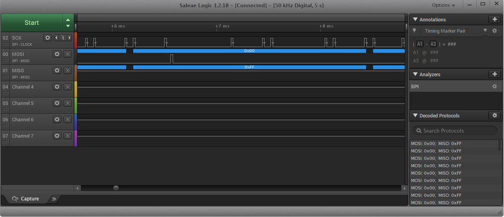

Not sure what I'm supposed to see in the screen shot, show one sequence that describes the behaviour you want to show.

Hello Jan,
Thank you so much for your valuable time on my question. Screenshot attached below for further inputs. Working on your other questions.
Thanks
Muthaiah Murugappan
‎2018-06-11 8:56 AM
Hello Jan,
Thank you so much for your valuable time on my question. The issue with the behavior of the clock and MOSI pin(their irregularities) is the sequence i wanted to show. Working on your other questions to check the respective pins.

‎2018-06-11 9:47 AM
I'd suggest slowing your SPI clock and increasing the Saleae sample rate to the point you have a 4x ratio. That should clean up the display.

‎2018-06-11 2:17 PM
If I'm reading the displays you've posted correctly it's configured for a 50 kHz sample rate. If you reduce the number of active channels to only the SPI signals you need you should be able to configure it for a much higher sample rate. (My old Logic 16 is currently configured for 7 channels @ up to 40 MHz.)
