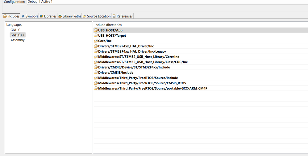

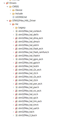

I am receiving errors such as 'HAL_StatusTypeDef' does not name a type; did you mean 'NOR_StatusTypedef'?' and 'HAL_LockTypeDef' does not name a type' in my files in STM32F4xx_HAL_Driver/Inc . i create project automatically with stm32CubeIDE. What causes these errors?Thanks
Typically, this happens when you include a file other than stm32f4xx_hal.h, which is the only file you should be including from user code.
If you correct that and are still having problem, show the full output of the Console tab.
If this is all code generated directly from CubeMX, include the IOC file so the error can be duplicated.
