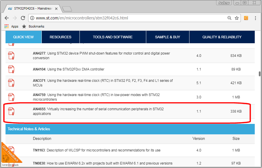

Posted on January 24, 2018 at 10:39
The principles are going to be the same as for any microcontroller.
Always worth going to the Product Page for the chip concerned and looking at the list of Application Notes; eg,
Which is the one that
Turvey.Clive.002
‌ alluded to, and
Golab.Bogdan
‌ linked.
But why not just choose a variant with sufficient real UARTs ... ?
Posted on January 24, 2018 at 11:00
Yes, software emulation is bad especially if you have so many resources as STM32 has.
Hardware resources offload CPU - you do not have to spend time on right timing (clock counting, etc).
